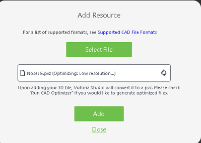

I will try your solution... However, I expected to solve this issue about CAD Optmizer keeps in this status forever (see img below). How can I solve it?
@sdidier still waiting for your answer...
My CAD Optmizer only works the .med and .high optimization... The low resolution is not working (loading forever). See .log attached. I just need to know how I'm able to use the optimizer only in the .med and .high, skipping the .low process.

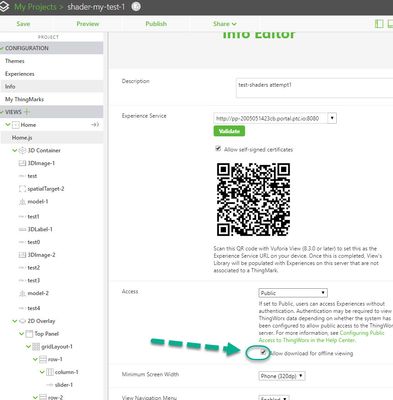

for point 2.) of your question / large assembly + low network performance - > did you consider the option to use offline mode:
so you can download to the device and later used it in offline mode- this does not require - every time when you open the experience project  to load the models again / the experience is loaded only one time to the device . You need to reload/update the experience only for the case that it was changed

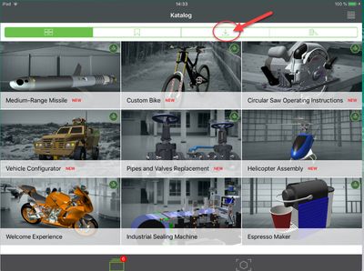

Thanks @RolandRaytchev !
I was trying to find this option in Vuforia View without success. This will solve at least my network problem!

1.) the first requirment is that the project was published with the mentioned option to allow offline usage
2.) I think to find it - it is little different , depending on the OS. What is the mobile platfrom of you Vuforia View app? I could check .
Another point is -I believe , is to set also the server in the app by scaning the QR code (for setting not the project QR code == deep link for calling it) So it should point to server from where the experience is called
