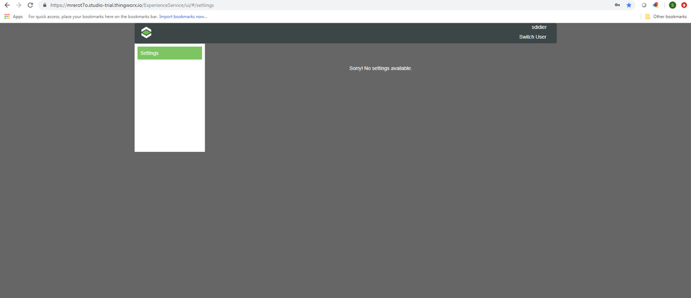

I am able to connect to the instance and to ping it correctly in Chrome, by using this URL :
https://56bd2e111bd407c7.studio-trial.vuforia.io/ExperienceService/ui
https://56bd2e111bd407c7.studio-trial.vuforia.io/ExperienceService/ping

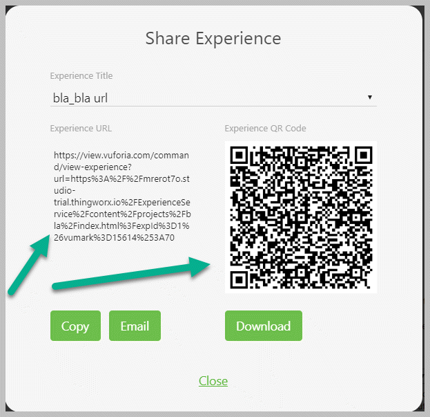

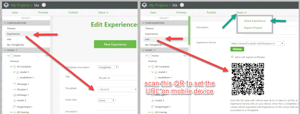

Did you use the correct thingmark when you try to access your experience from the end device. So to find the project you can use a thingmark which could be specified in the configuration > Experience
You can set the device URL directly  via scaning the QR code in the Configuration> Info
All trial servers are registered to the GXI service only for a specific thingmark domain.
So for example when we have the ES URL https://my_test1234.trial.com in this case we will have specific domain e.g. 12345 and the thingmarks will be 12345:1, 12345:2 ...  12345:10 .... Only the experiences using this thingmarks will be found by the GXI service - means you mobile device could find them.
But you can use any thingmark for your experience but in this case you have to set the URL in the vuforia View application to the URL e.g   https://my_test1234.trial.com
When you did not use thingmark  to identify the project - in this case you can share the project -> Share>Share Experience. And use the Experience QR code or the Experience URL link to open the experience on the mobile device.

- in this case you have to check if you mobile device could reach the ES server
- or if you did in fact publish to this server and not anywhere else--- then simple pay attention to set the server URL in Studio and to publish again. Check that the message is coming that publishing was successfully
