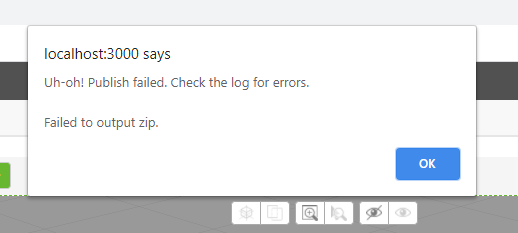

I'm having trouble with publishing projects since updating to 8.5.12.4700.
Vuforia displays this error when publishing.
Log file output as follows:
[2020-09-02T00:19:45.239Z] error: [twx-studio:projectHelper] publishTask error for project Target_Test_02_09_2020 Failed to output zip.
[2020-09-02T00:19:45.240Z] error: [twx-studio:api] Error occured while publishing project Target_Test_02_09_2020 Failed to output zip.
[2020-09-02T00:19:45.254Z] info: [twx-studio:ves-publish:1599005985216:Target Test 02/09/2020] filter out entry: extensions/js/libthingview_wasm.wasm

Hello Micah,
  • Do you have the log of Vuforia Experience Service also ?
It seems a Target Model or Image is used in this Project due to the name Target_test.
If the answer is yes, I would recommand to look these articles :
https://www.ptc.com/en/support/article/CS311736
https://www.ptc.com/en/support/article/CS300040
https://www.ptc.com/en/support/article/CS321715
Best regards,
Samuel

Hello Micah,
Thanks you for your feedback.
It is more clear from my point of view.
It is a local issue on the workstation, not in the server.
  • Can we have the log file of Vuforia Studio when the issue occurs, please ?
         I would like to see the verbose before the one reported before to find a possible root cause.
By the way, I have found this article :
https://www.ptc.com/en/support/article/CS320078
It is similar but in our use case, Project name seems to be valid.
  • Are you using in Windows or in MacOs ?
