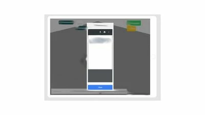

Hello, I'm trying to view pdf documents via ionic popups into the experience, but it seems to show them only in the strange and small area you can see in the attachment. I also tried to change some popup CSS settings but I didn't find a way to solve this issue. any advice? many thanksSenzanome.jpg

Thank you. In my case i solved with these settings:
.my-custom-alert .popup {
    // min-width: 800px;
    border-radius: 0;
    width: 90%;
    scroll-behavior: auto;
    position: absolute;
$ionicPopup.alert({
        cssClass: 'my-custom-alert',
        title: "Documento parte",
        template: '<iframe src="app/resources/Uploaded/document.pdf#zoom=50" scrolling="no" frameborder="1" marginheight="0px" marginwidth="0px" height="600px" width="800px" allowfullscreen></iframe>',
        okText: "Close",
