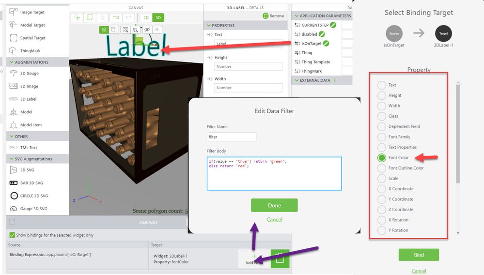

one option you c an try is in the solution code to replace:
$scope.view.wdg['3DLabel-1']['fontColor'] = "rgba(255,0,0,1)";
by $scope.setWidgetProp e.g. :
$scope.setWidgetProp(3DLabel-1','fontColor, "rgba(255,0,0,1)");

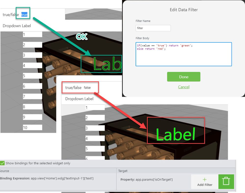

What I meant was something like this:
But to be sure if it work I tested it and work only one time but as you mentioned it will not update:
It seems that this will in generally not work for the frontColor of the 3DLabel widget. The property will not update when we change the value. For all properties such should update the color. I have no Idea why this not work here
As workaround/solution you can define a css style and used it to change the apperance of the 3D label widget:
