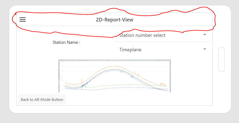

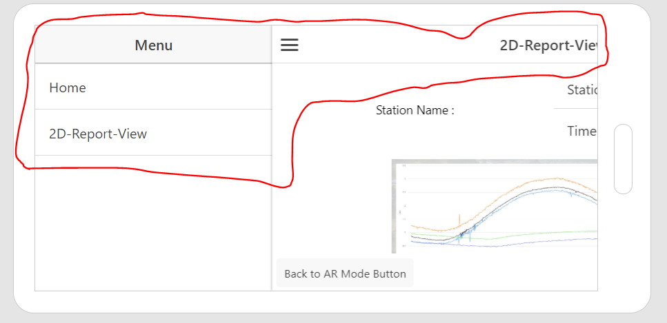

I would like to make view-navigation-menu go hidden as i configure it on info menu.
It's not go hidden as configured. as shown below

Hello Paltoon,
I have some questions :
  • In Views, in 2D, are you using Header or Footer Widgets ?
           If the answer is yes, please see this article :
           https://www.ptc.com/en/support/article?n=CS313270
           If the answer is no, to hide Navigation Menu, please follow these steps :
  1. In Vuforia Studio, in the Project, in PROJECT panel, in CONFIGURATION section, Info menu
  2. In View Navigation Menu list, select the Hidden item
More details in Help Center :
http://support.ptc.com/help/vuforia/studio/en/index.html#page/Studio_Help_Center/ConfigInfo.html

Paitoon1-VisitorAuthor
October 2, 2019
Yes..... I have footer in 2d-report-view. so i remove and update about configure hidden again and now hidden menu work. it hide`!! Thank you
