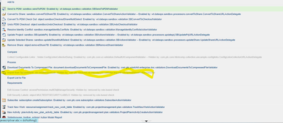

Hi @avillanueva ,
If I run jcaDebug in Project container, I can see Import from spreadsheet option which is grayed out(see attached screenshot).
Question : Import from spreadsheet is grayed out in Project container, Is it due to ACL or OOTB validator?
HelesicPetr
(To:V_THAKARE)
@V_THAKARE
Generally it is based on the validator.
if the function is greyed out based on ACL it is also checked by validator and the validator checks the ACLs.
PetrH
