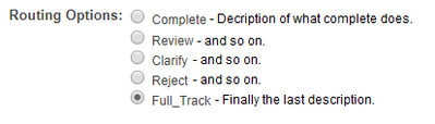

I would like to modify the text of the Routing Options radio buttons to give the user more information about what each option actually does. I have put the information above in the "instructions" area (as seen below), but typically people don't read it. 😀
In my lovely mock up, I would like the Routing options to look like this:
I understand the the text is driven from the workflow Routing tab and I don't think it can be changed, but thought maybe some savy person has a solution.

Jmomber,
I've only seen the instruction area customized before, and not the radio button text specifically, but maybe try logging a Support case with PTC support, as one of the Windchill customization engineers can confirm if that's possible or not?

Can simply edit the text in the workflow routing tab choices. Just make sure that the choices are exactly updated to match in the code section of the same tab on the right.
At times, text with spaces needs to be enclosed in quotes - check syntax in that UI.
Note also though that Full-Track and Fast_Track are different. There is code that transfers this choice from CR to CN and affects the CN path.  Try other others first.
