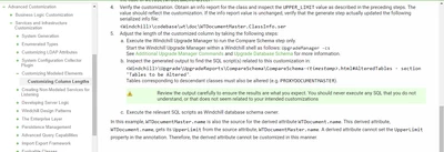

I need to customize the column length for Wt part .I have followed the steps from this link -Customize column length . At the last step it has been mentioned that , we need to execute all those relevant queries in DB. My question is that do we need to manually execute those queries in database or Is there any ways that automate that execution.

You have to manually execute the entries from HTML File mentioned under Altered Tables section.

+ This feature has nothing to do with "heavy" customization even mentioned on the customization section on the help center, it only requires shell access.
The last step generates the SQL queries (alter tables along with indexes) based on the database provider whether SQL Server or Oracle, you have to execute them manually one by one as @bhushan.d  mentioned from the database client (prefer to use GUI client to avoid any error, SQL Developer for Oracle, Azure Data Studio or Management Studio for SQL Server).
