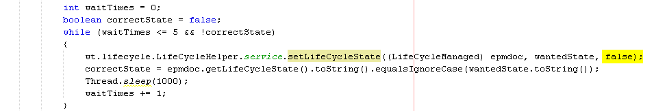

I have a problem that is pending for 2 weeks now, and I can't find the cause of it. I have a call to a method inside a java expression that looks like this;

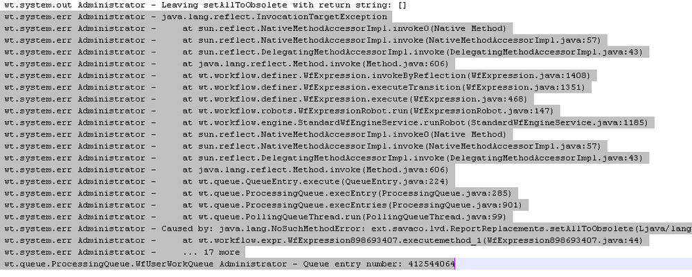

 The method executes and I see results in the bg method server but when the method terminates it gives next error;

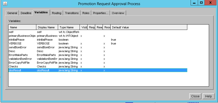

Snap3.pngI am sure I am returning a String. obsResult is defined as a Java string in the properties of the Approval process.
Snap4.pngWhat can be the cause of this error, please help ?

The problem is that Windchill can't find your class and method. Please check first, if the java class is copied correctly to the server or if you have any typo in the call.
It says clear: No such method error
Strange that the method server first executes the code, so it must find it, then outputs the error,...
This is more then a typo going on here....
What happens when you press "Check Syntax"?
Everything is okay, it says. Strange if I give with "null" to the method the error is not comming and it returned properly. I recompiled the class file and it commes out ok.
No such method error shows "Ljava." it is looking for a method with Array, not sure why.

The culprit is found, it was a call to set the lifeCycleState. When only 2 parameters are given (LifeCycleManaged and wantedState) then this method is terminating the workflow processes associated with this state that are open. In other words it was killing it's own, returning an invocation exception. Optionally there is a call to a method with 3 parameters, where the 3th indicates if processes needs to be terminated. When I use next all is ok.
