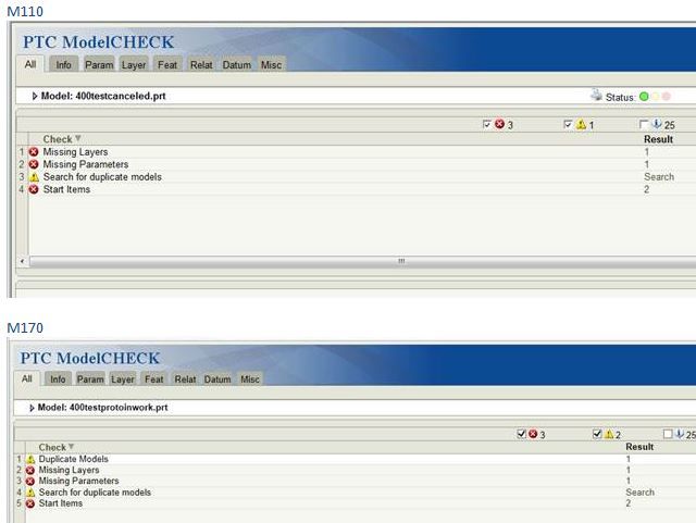

Do a lot of you use the check for duplicate models capability in ModelCheck? If so, does it work well for you? Anyone know of any good videos/information demonstrating this capability?
We have been investigating this. I have looked at geometry search through ModelCheck.
Although it does search for duplicate models the feature is limited. Part of the problem is the model has to have the density added to every model.
There were also issues between builds of Creo 2. In M110 I only get the Search for duplicate models check in ModelCheck. But in M170 I also get the Duplicate Models check in ModelCheck.
As I mentioned ModelCheck doesn't give you alot and therefore we started looking at other software. We are getting close to making a decision. Yes, it does cost more but for us it is worth it.

We add the density (included in the material file) to our CAD files as SOP, so that isn't a problem.
We are on Creo 2, M210 as well.

It is very bare bones. That is part of the reason why we decided against it.
I spent a lot of time with PTC tech support because it wasn't working the way the help said it should.
We have been adding the density to our models for about 8 years but we still have alot of models that didn't have it. That would have been a huge separate project we would have to do. Not having the density on many models is another reason we decided to go in a different direction and therefore I really didn't get a sense of how good or how bad it was at identifying duplicate models.
