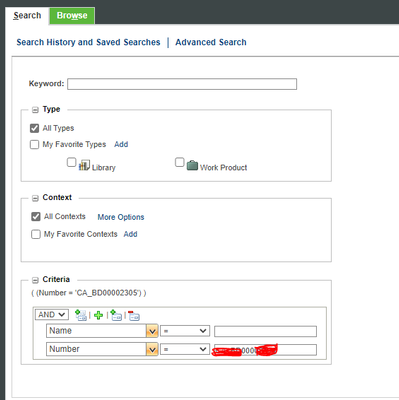

Is there any API to get any object from a given number which is unique.
manoj_dokku2
it should show results of objects, for the given (any unique)number as shown in the advanced search.
Hi @manoj_dokku2
I don't think so. It is not easy as you think.
The helper has a getPersistable() function where String is input but this string is defined as a type identification and OID it is not object Number
example> OR:wt.part.WTPart:26891877
Also if the advanced search is activated in a explorer, there is full list of searchable types as a parameter in a function. And the function is hardcoded :D.
I can't see simple function there that just search for Numbers.

Hello @manoj_dokku2
If you define correctly QuerySpec defintion, then you can use
PersistenceHelper.manager.find(QuerySpec QS)
QuerySpec spec = new QuerySpec(WTChangeActivity2Master.class);
spec.appendWhere(new SearchCondition(WTChangeActivity2Master.class,
WTChangeActivity2Master.NUMBER, SearchCondition.EQUAL, number), new int[]{0});
QueryResult qr = PersistenceHelper.manager.find((StatementSpec) spec);
if (qr.hasMoreElements())
I don't know another universal API.
I would define all types if I need to search all objects.

Thanks for the reply @HelesicPetr , I'm looking for generic query which will give the object if we pass the number(any) from Windchill.
You can use same above API by replacing
by WTObject.

I agree with you. My point was to use the basic or root object. So in your case you may use Persistable
hello @Ajit_Kulkarni and @manoj_dokku2
Unfortunately the WTObject.class can not be used to search by number.
error are presented in two cases
A persistence error occurred. System message follows:
one case searchcondition contains subtype WTChangeRequest2Master>
Nested exception is: wt.introspection.WTIntrospectionException: number column not found for V_ChangeIssueResource.
second case search condition contains root object WTObject>
Attribute "number" is not a member of class "class wt.fc.WTObject" Nested exception is: wt.util.WTPropertyVetoException: Attribute "number" is not a member of class "class wt.fc.WTObject" Nested exception is: wt.pom.PersistenceException: A persistence error occurred. System message follows: Nested exception is: wt.introspection.WTIntrospectionException: number column not found for wt.fc.WTObject --> N/A.
So if you need to search all existing objects, you have to define all subtypes in the query.
Also some type of object has a condition parameter number and some of them has master>number
and this will case may troubles.
So In my opinion a general API to search in all unique numbers in the system do not exist.
You have to write own function where you define all master types.
