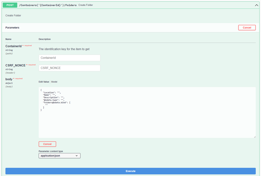

can anybody have a hint of what am I doing wrong? I am trying to create subfolder in the Windchill, using Postman application but all I got is the message "The syntax of the JSON document is not valid.".
The query is POST:
https://<myserver>/Windchill/servlet/odata/v5/DataAdmin/Containers('OR:wt.pdmlink.PDMLinkProduct:169546')/Folders('OR:wt.folder.Cabinet:169590')/Folders('OR:wt.folder.SubFolder:248107')/Folders
and the body is: (the example is from WIndchill REST Guide 2.4 page 466.
 "Name": "NewFolder",
 "Description" : "Desc",
the headers are:
Also, Authorization is done using wcadmin account.
I tried different data in json body but without luck.
Does anyone have a clue what is the problem?
Best regards!

Hi @nbojcetic
Try to create the folder from a Windchill restApi documentation UI.
You can try it from the UI and you can find if the json is well formatted.
https://serverAdress.com/Windchill/netmarkets/html/wrs/doc.html
examples
"Folder@odata.bind": "Folders('OR:wt.folder.SubFolder:199456')"
"@odata.type": "#PTC.NavCriteria.WTPartStandardConfigSpec",
for the type I would try to find a type for the SubFolder. I guess it could be something like
"#PTC.Folder.SubFolder" but I don't know exactly.

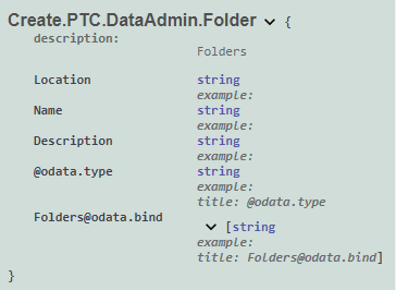

@nbojcetic , @VB_2025784 Please use the Swagger UI to run endpoints, your payload does not contain all necessary data as @HelesicPetr explained.
Also, it could be a permission issue, try to create the folder on the exact context with the same user on the UI; but I guess it's not the root cause.
Any idea how to add the service to a ThingWorX OdataConnector? I found the endpoint createContainerInContainers/v6/DataAdmin/Containers Post but create Folder isn't shown. Looking at the Swagger JSON the parameters should be what is shown below. I tried adding that to the JSON Container parameters but it is not considered valid. I am looking for a way to create folders in Windchill from ThingWorx.
