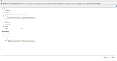

Oid is missing in "Set New Name" Jsp under save as
  • May 10, 2023
  • 633 views
I am not able to find it out OID on the "Set New Name" actions jsp in WC12.
In WC 11 I can able to see the OID is there at the end of URL.
Steps :-
1) Save as any WTPart
2) Click on "Set New Name"
3) In that JSP Oid is not there in WC12.
I have doubt is it there in WC11?
@avillanueva @HelesicPetr
HelesicPetr
May 10, 2023
Hi @BA_10670508
I can just confirm, that the OID is not part of the URL for the Save As operation also for the Set new Name wizard
I checked it in Windchill 12.0.2.7 and 11.1.2.14
I can just add that Save As action is not new window so the link is not changed and oid is not there because the wizard is inside of the page.
If you go to the detail page and use the save as from the actions then OID is in the link but if you activate save as from folder or different place, the oid is not there.
