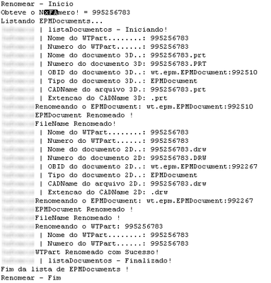

Hi, just to Close this Topic. I was able to solve the problems.
Follow a image from the right results

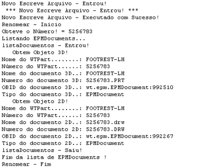

News about the development. Now i'm getting both right file names, 2D and 3D.
It´s in my language (portuguese) but you can see i getting the .PRT and .DRW
My challenge is rename them! If anyone can help me, i appreciate.
