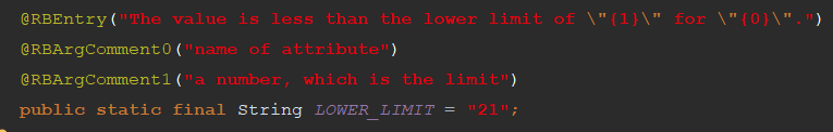

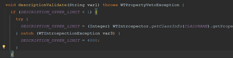

The result was a new Change Request with my preset field values for my business case. As of today, this code fails on the cr.setDescription() call with the following message:
Message: Resource bundle/Message key = wt.introspection.introspectionResource/21
I haven't found any reason or solution yet... but I am assuming someone has. Anyone have some ideas?
