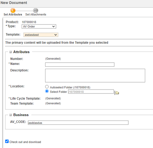

Hi Community,
I created a new flow by clicking new template from the templates page. But the flow gets stuck at the first step and gives an error that it should not give, what could be the reason for this?  Even though I defined all the parameters correctly, nothing changed.
Code:
wt.doc.WTDocument doc = (wt.doc.WTDocument) primaryBusinessObject;
 docNumber=doc.getNumber();
 docName=doc.getName();
 Error:
wt.workflow.engine.FailedExpressionException: wt.util.WTException: java.lang.NullPointerException
Nested exception is: java.lang.NullPointerException
Nested exception is: wt.util.WTException: java.lang.NullPointerException

Hi @smcvr
You should be sure that the primaryBusinessObject is not null and also is the correct type.

Hi @HelesicPetr
Yes, I am sure. When I try it with another previously created workflow, it does not give these errors. I think I'm getting this error because I created this with a new template.

Hi @smcvr
In your code something is null(empty, without value), and you need to find what it is.
