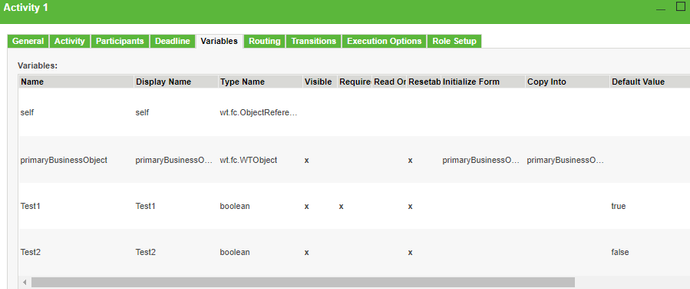

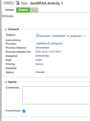

I am not sure that article means what we think it means. I just created a workflow with two boolean attributes and tested it. Displays like this:
You should be able to create a variable in the workflow and also in the task to gather inputs. Then you can write logic around it. Am I missing something? Seems pretty OOTB.
So I can definitely do it in the workflow... I know how to get user input variables in there... and even pass them to the task.  But... That screen shot you have... is that from a task?  The user would have to input that in the task.
Yes, that is the task page. You add boolean variables to the task and you make them visible and editable. It should join to the same variable at the process level so you can use it in logic code. Seems like you know about workflows. I do not think I understand the issue of why it cannot be done.

Hi @ChiselnMallet1
If you set the attribute it is generally shown in the input of the task. In my case
Boolean CheckParams
I just set the parameter as required

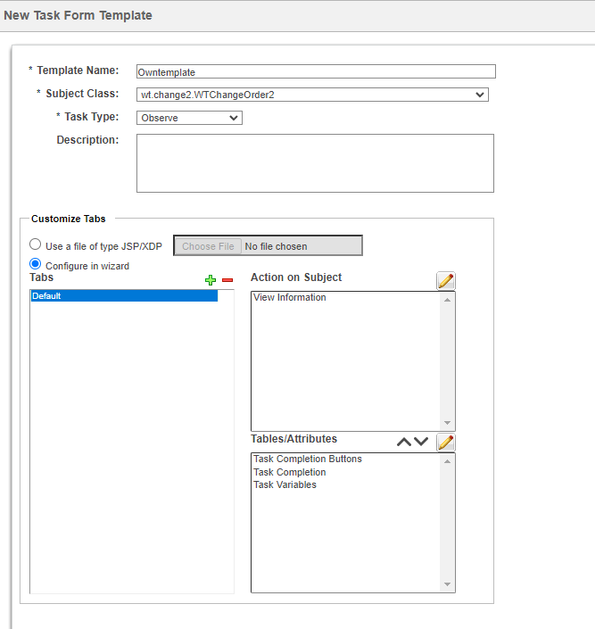

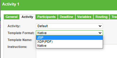

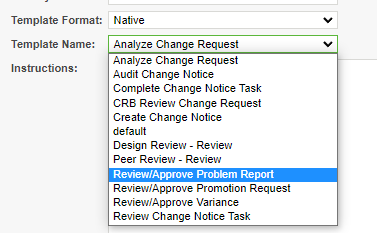

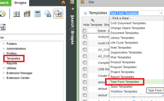

Hi @ChiselnMallet1
It depends how the template format and template are set in the Workflow definition.
For native format, you need to define specific format where you can define what you see.
The native format definition is done on site level in a task form template
This task form template should be available in wch 11.1+ so your windchill should support it
PetrH
As usual, being very precise in terminology is needed.
General simple case (workflow only): Create and use variables only within the workflow.
- Create as global workflow variables; possibly set a default value (if string, this can serve as a brief instruction)
- For each task or robot that needs to address variable(s), create, then initialize from; set permisssions
General more complex case (PBO attributes):
- Create workflow variable(s) as above, corresponding to PBO attribute(s); have to match data type (e.g. String)
- In workflow robot, "Get" current value of PBO attribute (e.g. an attribute on a Change Request)
- If user needs to set value, Initialize workflow variable to Task as above
- In workflow robot, "Set" the updated value back to the PBO
In either case, the layout of the Task can be managed via task templates
