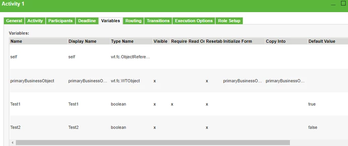

I am not sure that article means what we think it means. I just created a workflow with two boolean attributes and tested it. Displays like this:
You should be able to create a variable in the workflow and also in the task to gather inputs. Then you can write logic around it. Am I missing something? Seems pretty OOTB.
So I can definitely do it in the workflow... I know how to get user input variables in there... and even pass them to the task.  But... That screen shot you have... is that from a task?  The user would have to input that in the task.
Yes, that is the task page. You add boolean variables to the task and you make them visible and editable. It should join to the same variable at the process level so you can use it in logic code. Seems like you know about workflows. I do not think I understand the issue of why it cannot be done.

Hi All... thank you for the input so far...  I can create the variable in the process, and activity.... but I am at a loss for getting it to just 'show up' in the task.  Where do I set where that variable is located as a check box in the activity..  Simply creating the variable doesn't get it to show up in the activity does it?
edited 5 min later... ok.. so it does just show up... but by pure chance it's because I added a new tab to the layout with the variables on it previously when I was experimenting.
Need to figure out how to get it to show on the first tab now and collect the info.

If you set the attribute it is generally shown in the input of the task. In my case
Boolean CheckParams
I just set the parameter as required

My OOTB set up isn't dropping it in there.  11.2 by the way...  And my table/attributes is not called "Inputs" like yours.  Mine says task completion.  I'm guessing that I just haven't figured out where to edit those task template options.  I had to add the Task Variables option to my Task Template to get them on the the first tab.
Where do I go to mess with that stuff?!
Hi @ChiselnMallet1
It depends how the template format and template are set in the Workflow definition.
For native format, you need to define specific format where you can define what you see.
The native format definition is done on site level in a task form template
This task form template should be available in wch 11.1+ so your windchill should support it
PetrH
