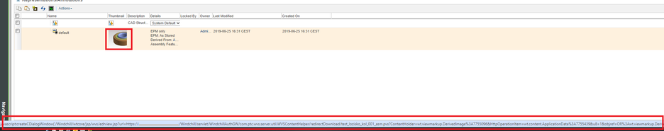

Is there an API to generate the creoview URL(creoview://?wcparams=...) that launches the Creo View application for a given list of part(s) with the version?
Note : There is this OOTB REST endpoint(../Windchill/servlet/rest/visualization/objects/) that does it with OID and version, just curious if it can be done via API and also for a list of parts.
HelesicPetr
(To:MV_10441462)
Hi @MV_10441462
If you check the open representation link, then you can see that the API has to exist
PetrH
