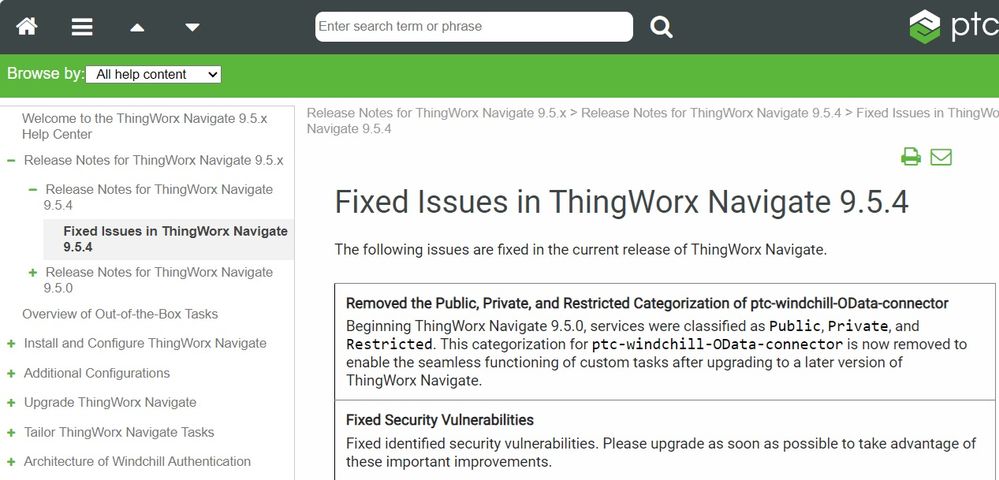

As of now, Thingworx Navigate is using ptc-windchill-OData-connector. I need to use an xyz-windchill-OData-connector by the Thingworx Navigate as the default; how can it be done? what changes need to be made to achieve this?

So, building blocks were introduced in 9.5.0. Since then, due to the Access Modifiers concept, most of the services can't be used, So a whole new project needs to be created or duplicated with existing ones and assigned to another project and re-create the entire structure step by step, which includes creation and configuration of the Odata Connector too.
There is no other way or workaround at this time.
