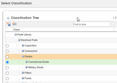

We are using Windchill PDM link 10.2 and we are investigating if the use of Partslink brings any added value for our company.
Therefore i am on a testenvironmant looking how and what can be done with Partslink for catalogue parts.
During the creating of a WTpart you can select the creating classification items.
During the selecting of the classification criteria is there any possibility to add the exiting image from the selected class?
The image is automatically shown if you do a search request for existing items, but it would be a great help for the users if they can see the same image during creation of new items??
Thanks for the support.

Wow, such an old post. Hopefully the user is still around and implemented Parts Link. For clarity, I think the user is meaning this screen:
Images are not show. I think this should be an idea submission since it has not been done yet. Thinking of the practicality, the image would increase the length of the UI greatly. Mouse over pop up possibly? It might get cluttered but I like the idea.
