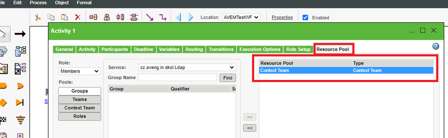

Hey everyone, this might be a bit of an odd request. When I usually go to reassign a task to a different user, I can either select the user from the dropdown menu or I can click "Find" to do a search for the user. From that point, that user will appear in the dropdown for selection by other people in the org. That is no longer the case for me. Does anyone know where the reassign dropdown entries are stored?

The list is linked to a task definition in a workflow template.
There is a resource pool where you can define users that could be added to the role of the workflow.
OOTB there is all context so the list is from the team definition of the product or library
role guest is excluded from that list. (guest can not be part of the workflow OOTB)
