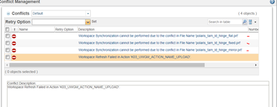

I have this entire assembly, that I can't check in (not even a single part). Always appears some sync error related to the same parts:

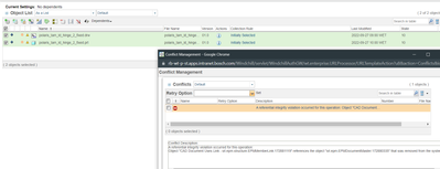

Already tried to remove them from the workspace, drawing included (using the browser access), but a different error appears:
It is really important to have this error figured out, otherwise I won't be upload my entire work to organization.
This ticket seems to describe your issue:
https://www.ptc.com/en/support/article/cs20353?language=en&posno=1&q=Workspace%20Synchronization%20cannot%20be%20performed%20due%20to%20the%20conflict%20in%20File%20Name.&source=search
You might have to back up your work outside the workspace to folder, clear contents, create a new workspace, import items back into new workspace and try again.
2 REPLIES 2
Hello @avillanueva . Thank you very much for the quick reply.
This would be probably my last resort...but I'm almost sure now, that it might me my Only one.
Thanks once again
