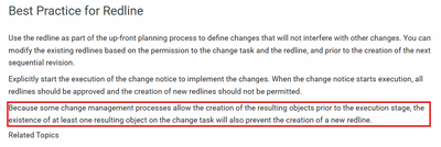

I am using Windchill PDMLink Release 13.1 and Datecode with CPS 13.1.2.2
ECN产生的对象有内容时就没办法创建红线,移除产生的对象后可以创建
Here are the errors that I faced
无法完成此操作,产生的对象已存在于更改任务

@Sarah_Rong,
The existence of at least one resulting object on the change task will prevent the creation of new redline. Please refer WHC
Prajwal
