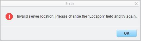

My company finally upgraded from Pro Engineer Wildfire 4.0 with Windchill 9 to Creo 3.0 and Windchill 10.
Before installing Creo on my laptop, I cleared my workspaces and deleted my cache. Creo is working and can find a license without issue. However, when I try to register the Windchill server under "server management", it fails to connect when I click "check" and then I am asked to check the server location.
I know the URL is correct as it is working for my coworkers. I can access Windchill through Internet Explorer on my laptop also. I have tried reinstalling Creo, restarting my computer, and trying to connect with and without the wireless connection.
I've tried researching this issue and the only solution I came across involved deleting the cache which I have done several times.
I'm out of ideas. Can someone please help?

Well it turned out that the Creo Platform Agent had become corrupt. I have no clue what the Platform agent is, but it's installed with Creo. The fun part is that it doesn't automatically uninstall or reinstall with Creo. You have to go through the control panel and use the add/remove programs to find and uninstall the Platform agent.

I just put 2 system environment variables in a batch file that runs from parametric.bat to define the location of the Creo Agent files.
@rem ***** Set Creo Agent *****
set CREO_AGENT_EXE_PATH=X:\PTC\CreoAgent\Agent\creoagent.exe
set CREO_AGENT_LDP_LIST=X:\PTC\CreoAgent\Platform\4\manifests
(not my real path names, but you get the idea)
I recently upgraded from Creo 3.0 to 4.0 and also received the same issue. The main problem for me was that the cache location for Windchill was the specified as the same folder for both versions of Creo. You can get around this by changing the cache location. What worked for me was to delete the old Creo 3.0 cache folder and then I was able to add the Windchill server no problem.
Server Management > Cache Tab - This shows you the location of the cache. For me it was:
C:\Users\username\AppData\Roaming\PTC
I just deleted the whole PTC folder in that location (may be hidden).
