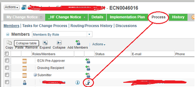

We have a group of people that have recently left the company. Therefore, I ran the Search for Disconnected Participant and Delete from Windchill.
The issue I have is that, some of these users started workflows. When you reassign a workflow to another user, it always comes back to the process initiator. However, the initiator does not exist. Is there a way to change the Process Initiator or reassign the task permanently?

On the "Process" tab.

Yes, in the Participant Administration, I did Action -> Delete from Windchill.
We had reassigned the worfklow to a temp user. But now we have a permanent user. The way our workflow is setup, once a task completes, it always goes back to the workflow initiator to decide which direction the workflow should go next. By reassigning, it goes back to worfklow initiator EVERY time!
I tried the calendar, but since the user has been deleted, I can't search or find that user to delegate tasks in the calendar. Can I re-enable the user, and then set the calendar?

You can change who the person is listed as on the Process tab.
Darquise
(To:STEVEG)
How do you change it?
Darquise
(To:STEVEG)
Hmm, interesting. I like that. However, I don't have the ability to add Process tab.
Under task I can add Process Status.
Under subject, Routing/Process History.
Where/How can I add process tab?
In the meantime, I asked our administrators to enable the departed user. I was then able to search in the calendar and set all his tasks to another user indefinitely. However, I like the idea of changing the process initiator as per your screenshot. Would like to pursue that. Just not use how to add the Process tab.

Maybe you get it only if you are administrator?  I didn't test that.
Darquise
(To:STEVEG)
Ah yes, i found it. I had to add the "Member" link within Collaboration of History->Routing/History tab.
I think that will work. Thank you 🙂
