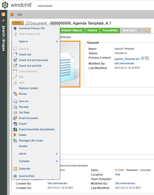

I see I failed to make my point. Promotion request would be what I'd use, but it's not possible, there's no New Promotion Request in the template's Actions menu..?

There's an admin user id specifically for Org-level where templates are maintained and even for that user there's no New - New Promotion Request in the template's Actions-menu. With the same user looking in the Actions -menu for a document residing in a Product context and created from that template there is. This makes no sense.
Again with the same user you're able to find the template via search and from the results' Actions-menu it seems to be possible to initiate the Promotion Request as you suggested, thank you for the tip! 👏
With a 'regular' user testing to promote the template from search results' actions menu there's the yellow warning triangle stating that the user has no rights for promotion in the particular context (org) which is correct.
However, this has no logic to me. Is there a setting specifically for templates somewhere which hides/unhides the functionality from a template's Actions?

TomU
(To:STEVEG)
It's weird that the new promotion request action is available from the search results actions but not from the object itself.
Not from the object's page:
Not from the object itself:
From the generic search results actions:
STEVEG
(To:TomU)
Yes that is odd.  But I never had more that 1 or 2 items to promote so I would normally just search for it then create the promotion request from there.

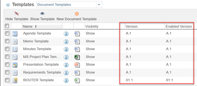

MikeLockwood
22-Sapphire I
(To:HJ1)
Need to manage this in general by paying attention to the Enabled / Enabled Version columns.
Only those enabled are available for users to select for New Document.
Only the enabled version is available at that time.
Can create / develop a new version and then make it avialable for use only after setting that version to enabled.
