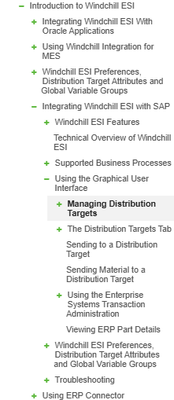

Marco_Tosin
(To:TomU)
You must associate a distribution target with the object to be sent and then manually send it to the distribution target.
In our system, we also have a customization feature that allows you to send multiple items to the same target at the same time.
I forgot to mention that Windchill is connected to the ERP via Tibco through ESI.
Below the guide section where the above is explained
Marco
