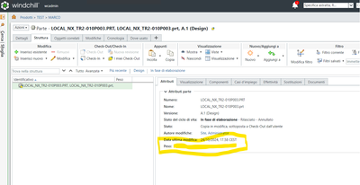

Hello, some one knows how to create 1 or more attributes editable to insert in structure wtpart or similar.
For example i would like to insert "weight"
in this page

Yes just done.
But WTPart -> structure page is not editable. (only just if i check-out and modify).
Is there a way to edit it without checking out?
No.. you have to checkout the WTPart in order to make edits. This is one of the core functions of Windchill. so that changes are tracked.
