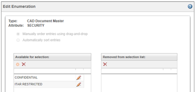

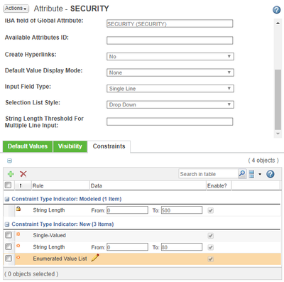

I created a new attribute for one object type in Windchill and then added an enumerated value list constraint to it with two values.
