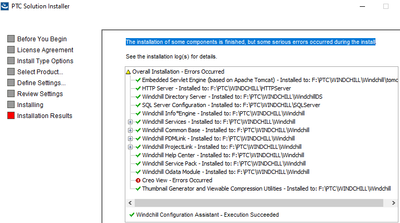

Dear all
i have attached the error which i got after running Windchill 11.1 psi.
Please provide me with the solution.
Thanks & Regards
Vipul
1 REPLY 1
This is a known issue regarding Creo View starting at 6.1 and Windchill prior to 11.2 based on change to structure of Creo View. The below ticket provides the steps. The short answer is that your current installation is fine even with the error occurring for Creo View. You'll use the Update Tool to resolve the issue post-installation.
https://www.ptc.com/en/support/article/CS315552
