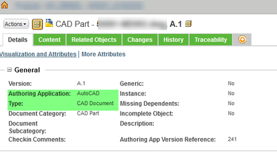

I am following the PTC support article to setup a Generic CAD Worker to create a pdf viewable using accoreconsole.exe (AutoCAD) of an AutoCAD .dwg file that exists as a CAD Document in Windchill. I followed all setup steps and am able to see my worker on-line. When I attempt to start the worker and publish a job (step 10) nothing is published. I don't think this is an issue with the AutoCAD portion (which PTC mentions they will not support). I think this is an issue with my Generic worker setup.

  • When I publish a .dwg from Windchill I get a job log (viewed in the WVS Monitor) and a Generic CAD worker log (found in the folder setup following the article).
    • The job log reports an error, with no detail. I notice in the job log that the Authoring Application is Creo...that is incorrect, but I am unsure how to change it. (job log attached)
    • The worker log makes it look like no actions are being taken. (worker log attached)

From the job logs
Feb 1, 2023 9:56:26 AM:Start: Other - 3000580.DWG, -.0
Feb 1, 2023 9:56:26 AM:Authoring Application: Creo
Feb 1, 2023 9:56:26 AM:Creo Assembly Conversion
This is suggesting that the dwg file you are trying to publish is authored by Creo instead of Autocad
- Do you know if this file was checked in via Autocad using WWGM ?
In the successfule job i would expect to see following
Feb 1, 2023 1:34:25 PM:Authoring Application: AutoCAD
Feb 1, 2023 1:34:25 PM:Transferring Files to: C:\ptc\Windchill_11.1\Windchill\temp\pubtemp\publish514906535694670529.tmp
Feb 1, 2023 1:34:26 PM:Number of Files Transferred: 3
Feb 1, 2023 1:34:26 PM:AutoCAD Component Conversion
The information page of the object should provide the details
Vishwas

Thus seems like the likely issue. I need time to setup WWGM, but will update when I have tested. Thanks for sharing this helpful info.
