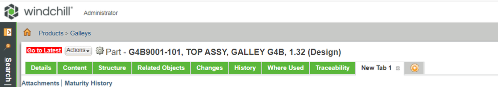

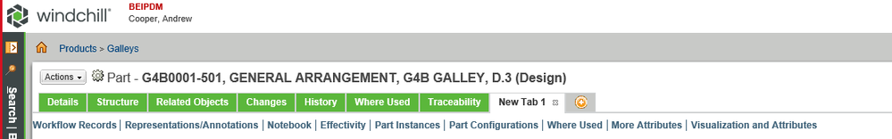

How do I expose the WT_PART "Content" tab?

I am using Windchill PDMLink Release 11.0 and Datecode with CPS M030-CPS16

    This is my top menu for a WTpart. It is on by default.
    Has your sys admin turned it off or set up profiles that hide certain menu functions?
    February 15, 2022
    This is the old top menu

    This is the new system top menu
    It appears that the OTB configuration does not display the "Content" tab
    February 15, 2022
    I notice that one user is the administrator and the other is a named user. Is the named user part of the administrator's group or have admin rights? It looks like it may be a profile applied to the users but not the administrator.
    I just checked my Windchill 11.0 M030 system and a normal user is showing the same set of tabs that I pasted in here before.
