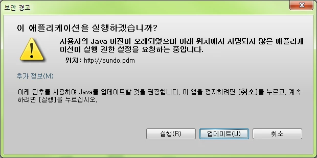

How do I get rid of the security warning that is displayed for each Java application run?
CHASEONHO
18-Opal
When you access a lifecycle template or workflow template in Windchill, the Java application launches.
Each time a security warning is displayed, you have to click Run every time to run it.
I would appreciate it if you let me know how to set it to run without the corresponding security warning.

There are a number of different configurations that seem to handle this differently. For the latest version of Java, Oracle shows a check box that could stop showing the prompt:
Trusted application with valid certificate
The yellow triangle indicates the application is untrusted or has an expired certificate, which is probably why there is no check box displayed. I don't see an English version of a 3 response dialog box, so I don't know what choices you have.
Your systems administrators should look at https://www.java.com/en/download/faq/signed_code.xml (So should PTC Windchill developers)
You may also look at https://www.java.com/en/download/help/jcp_security.xml for changes for the user level security.
thanks dschenken!
Three Responses The interactive box is Run, Update, Cancel.
Does that mean i need to issue a new certificate to get rid of the yellow triangle warning?

update your Java to the latest 32bit (even on a 64bit OS) . Try Java 8 first.

If you are on Java 7 (might be version 8 too) you won't be able to get rid of that security warning completly.
