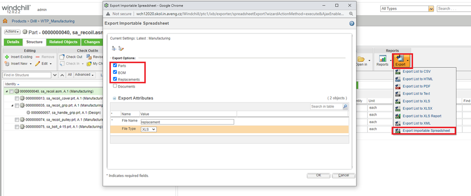

Hello users,
In PDM-link Structure BOM,
Apart from part icon, Replacement parts display as child parts.
While exporting the BOM, how to differentiate it and send it to supplier/other Unit.
Note: Using PDM link only, not project link.
Thanks!

HelesicPetr
(To:NSS)
Hi @NSS
Have you try an export to importable spreadsheet?
You can chose to export the replacements and it is in separated sheet.
It is not so nice but maybe it is better then the BOM export with replacement.
Also keep in mind that a unit is same for replacement part as the original part. So the unit is same.

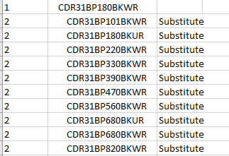

avillanueva
23-Emerald I
(To:NSS)
@HelesicPetr  suggestion might be correct if its about formatting but the MultiLevel BOM with Replacements does indicate that the line is a replacement. There is a column for sub type that indicates if Substitute or Alternate:
Above is how it exports so it should be easy to see that this is not a child component.
