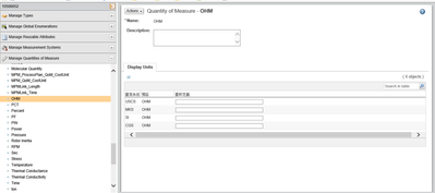

How to Modify Default Units From OHM to OHM(DCR).

Are you looking to change the display name? Or are you defining a new unit?  If the latter, you can create a new unit with that name.
This reply is from Akim in Shanghai.
Would you please refer below article try change to the Default Unit for your system ?
How to add custom Unit or hide OOTB "default unit" for WTParts in Windchill PDMLink
