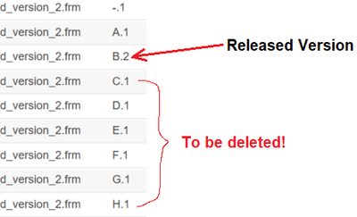

Hi there, the above is the screenshot about the issue: the released version of the drawing format is B released in 12 months ago. Since then, the drawing format has been accidentally revised to Rev H. We need to delete the drawing formats of revision C, D, E, F, G, and H. however, Windchill doesn't allow it, saying they are used in other workspaces.
How to delete them and only keep the released version B?
Thanks.

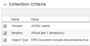

Purge can only be done by Site Admin. It's under Site / Utilities, Purge.
It's relatively complex - have to create a query with criteria and then run it.
For this particular case, a good approach would be to create a new Library, then move the Format to that Library, then run Purge on only that Library context, then move the Format back where it was. This eliminates most of the complexity for the query, etc., and ensures that nothing else will be purged.

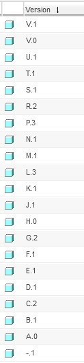

I could be wrong, but I don't think purge can remove a revision.
I just did a test and still have one iteration at each revision left:
I don't think it matters, but I'm running purge from the ORG level.

@TomU  has it right. A drawing references the master of the format NOT an iteration of a format. Therefore you should be able to delete from H.1 backwards until B.2 is the latest, unless the iterations to be deleted play the B role in any links. If that the case those links must be deleted first.
If they are in workspaces such a link exists and it needs to be deleted.
Are you getting the OOTB Remove from workspace option when you try to delete? I guess you are but drawings that’s reference the format are in the workspace too.
If a format is on an ECR the link to the ECR must be deleted before the format can be deletedas well.
You mentioned there are hundreds of drawings using Rev H format. I take it you mean Rev H format has info that you want to retain.
You also, mentioned ECR, is B the affected data on ECR?
Can you clarify EXACTLY what you want things to look like when your done?
For example, if you want B.2 to use the content of H.1 (or any other iteration) that’s easily doable. And it’s done without using Creo Parametric.
There are several ways to do this but let’s hear EXACTLY what you want done first.

The content of Revision H.1 (and G, F, E, D, C) is exactly the same as of Revision B.2.
One year ago, the drawing format was accidently revised 6 times (with NO change in content at all) to become H.1 in one single day.
Right now, we need to update the released Revision B to the new Revision C with new content added in.
Due to time constraint, H.1 was treated as the affected object in ECR, and J.1 to be the resulted object in the ECR. I have no idea how it will end. Can Revision J be released? However, we want the Revision C has the latest update and to be released.

If it were me I'd remove H from the ECR using the GUI
I'd remove C thru H from all workspaces. This will mean removing the drawing as well.
Then I'd delete H thru C.
Removing from WS could be a PITA using the GUI if you have a lot of Workspaces involved.
Who knows how many workspaces C thru H are in?
A Query Report can be written to find this info.
Or a utility can be written to be run in a Windchill shell.
In this case the utility would work by entering CAD Doc's number (maybe the rev too to get more granular)
The utility would then print the:
  • number rev.iteration
  • WS name
  • the user who owns the workspace.
After you know the Workspaces you could run the same utility with a -remove argument which would remove the object(s) from WS.
From there you can delete the H thru C using the GUI.
