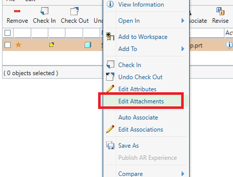

Use Case: A user has uploaded a file to a CAD part. It is saved as an attachment. I need to cleanup the CAD document and delete the attachment.
Description:
HelesicPetr
(To:rvainberg)
Hi @rvainberg
Add the CAD Document to the workspace,
Check out the CAD Document
From Workspace a Right mouse button action menu use the Edit Attachment function
Remove the attachment
Check in CAD Document
PetrH

rvainberg
(To:HelesicPetr)
Thank you @HelesicPetr . Problem is solved.
