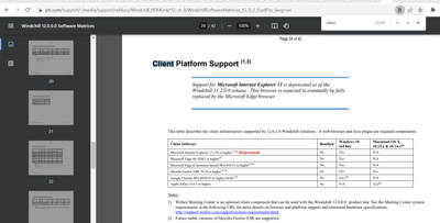

Is Windchill_12.0.2.5 compatible with client OS Windows11?.
CH_10078393
6-Contributor
I am using Windchill PDMLink Release 12.0 and Datecode with CPS 12.0.2.5
2 REPLIES 2
Fadel
23-Emerald I
(To:CH_10078393)
we supports officially  below as client , but using WC 12.0.2 and 12.1.2 on Windows11 in daily basis, never had an issue
for more info check https://www.ptc.com/support/-/media/support/refdocs/Windchill_PDMLink/12,-d-,0/WindchillSoftwareMatrices_12_0_2_0.pdf?sc_lang=en
