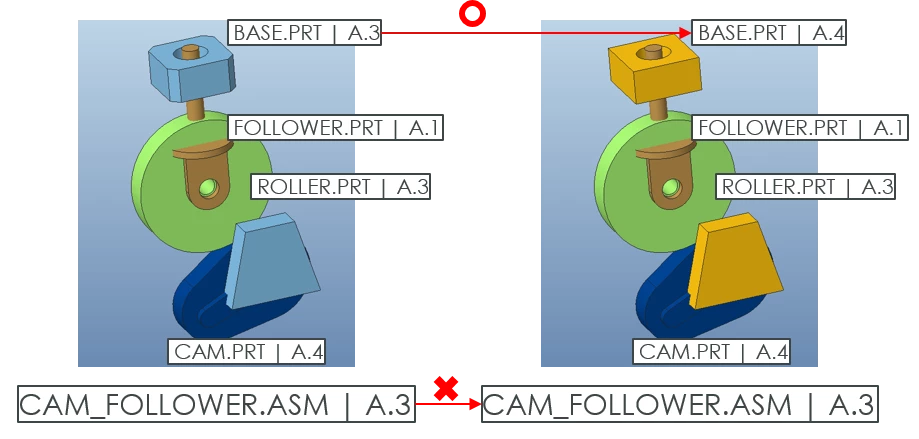

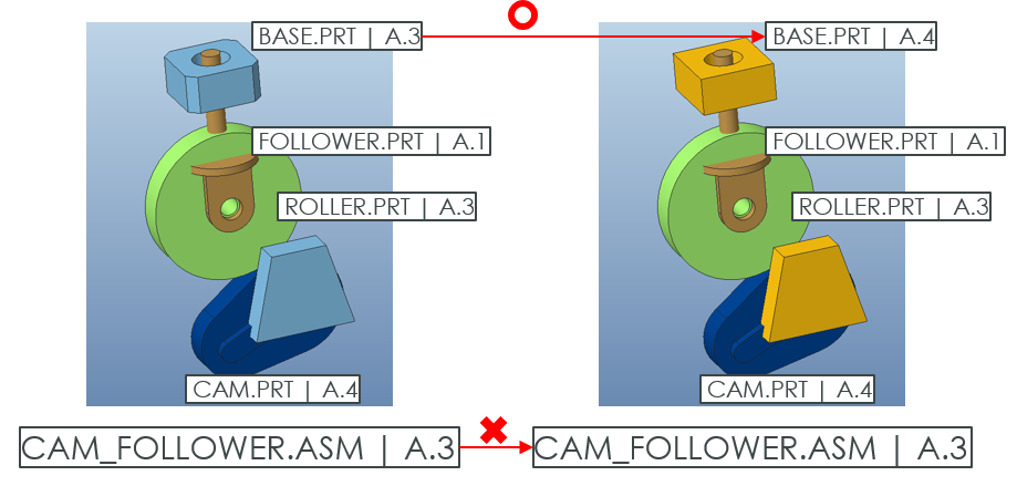

I will explain the attached picture and ask a question.
The expected scenario is as follows:
CAM_FOLLOWER.asm has 4 components.
Among CAM_FOLLOWER.asm, BASE.PRT is checked in from A.3 to A.4, and CAM_FOLLOWER.asm is not checked in.
In this situation, CAM_FOLLOWER.asm has been revised to B.1.
After checking in, iteration of version B increased, and it is necessary to view the latest data of version A.
The filters you can use to add data for A.3 in CAM_FOLLOWER.asm to your workspace are "Latest" and "On save". (Except promote and baseline)
If you select latest, CAM_FOLLOWER.asm is A.3, but the rest of the components get the latest iteration of version B.
If you select Save, you get the component when CAM_FOLLOWER.asm is checked in.
That is, BASE.PRT A.4 cannot be imported.
The point of the question is how to get the latest iteration of the assembled parts for the previous version.
I hope my explanation was good enough, and please leave a good answer.
