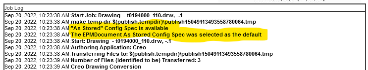

Check the WVS job monitor:

Log files get purged, so I had to create a new publishing job.
Sep 20, 2022 11:04:12 AM:"As Stored" Config Spec is available
Sep 20, 2022 11:04:12 AM:The EPMDocument As Stored Config Spec was selected as the default
