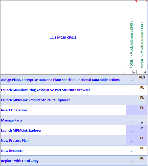

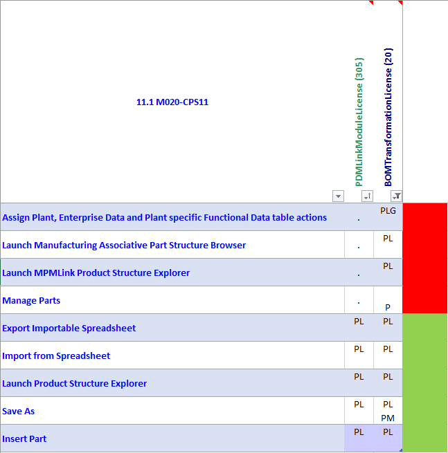

According to the 11.1 matrix, some aspects of BOM Transformation are available for PDMLinkModuleLicenses (previously named 'Heavy') and some are not:
It doesn't seem like any of the MPMLink functions are included in the PDMLinkModuleLicense:
