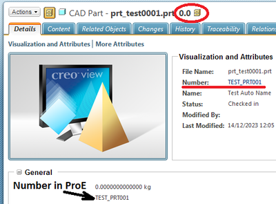

So, I create a new object in CREO. I give it a name and number. After check in, I see these parameters on the Windchill server:
In Windchill I see this attributes:
Version 0.0, Number in Proe: TEST_PRT001, Number: TEST_PRT001

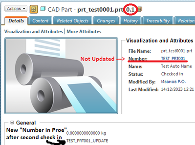

After that, I open this model in Creo and change the "NUMBER" in the model parameters. I enter a new value, for example TEST_PRT001_UPDATE
After that I make "check in". And I see this on the server:
The "Number" in the attributes was not updated. Is it possible to make it automatically updated after "check in" ?
For now, in such situations, I have to change the number manually in Windchill.

What attribute do you change in the ProE exactly?
It seams that it is just model parameter and it is not system parameter number, file name, or common name.
PetrH

Please share a screen with the attribute in Windchill detail page also with a name. Because I can not see it.
In a model, the model name is a number in Windchill.
PetrH

The explanation how the parameter is forwarded to the Windchill :
The behavior is based on model parameter setting.
If the model parameter option Designated is set to yes, then workgroup manager tries to upload the value to the database to an IBA attribute prepared in Windchill.
This IBA attribute tan be changed by check-out/in.
System number can not be changed that way, and you always have to use rename function to change the number
PetrH
@HelesicPetr
That is, these parameters are assigned to attributes after the first "check in" and then they can only be renamed only in Windchill? Did I understand you correctly?

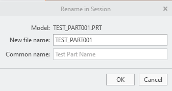

How are you changing the name in Creo?
Screen shots of the steps and commands will help.
I created a new part and checked it in.
File - Manage File - Rename on the file created a new file in Windchill.
The file name is PTC_Common_Name parameter, I believe and cannot be changed in session.
It is greyed out.

Let's step back here. I saw your other old post so you can ignore my message. Note there is a different between renaming in Windchill, in the workspace and in Creo.
  • Rename in Windchill will change identity of object (name, number and/or filename) but its the same object. All references to are maintained.
  • Rename in the Workspace is similar but can only be done before object is uploaded. After that, see above.
  • Rename in Creo, unless blocked by config.pro, acts like a copy or save as to Windchill. Note, there is a save-as in Windchill which you should explore since it may be what you are trying to do. By using Rename in Creo as @BenLoosli showed on 12/14, this will create a new item in the workspace.
Once and object is checked in, you will see these parameters in your model which are controlled by Windchill and cannot be changed in Creo. They should indicate locked. These are the values you see on the Windchill details page.
You mentioned that you changed  the "NUMBER" parameter in Creo and it did not update in Windchill. Yes, that is expected since you cannot have a designated parameter drive those parameters I showed above. There is the option to bootstrap in once via mapping in preferences once, before check in but that's it. They will not be in sync after that without some customization.
We have a rename listener that I developed to handle syncing the PTC_WM_NAME field with a TITLE parameter that we call out on drawing title blocks. It could work similar for what I think you are trying to do. Since in the drawing development process, the TITLE may be filled out later after check in and I wanted to keep in sync with Name in PDMLink, this detects changes to the TITLE parameter and triggers a rename event in PDMLink later on. Hope this helps. A lot can be done by workflowing your new model creation process and getting mappings right in site preferences. K.I.S.S. principle applies.

In my creo there are no parameters PTC_WM_PART_NAME, PTC_WM_PART_NUMBER, PTC_WM_NAME, PTC_WM_NUMBER. I already found a case on this issue https://www.ptc.com/en/support/article/CS287504
Did I understand correctly that if the model has already been unloaded and the model has a windchill part with attributes, so if I change the parameter "NUMBER" in the model in Creo, and make "check in", windchill part parameter "NUMBER" will not change in any case?
HelesicPetr
(To:Hozaibergen)
Hi @Hozaibergen
If the parameter "NUMBER" is an IBA Attribute defined as a global attribute and assigned to CAD Document and WTPart types then it should propagate the change.
But if you are talking about system parameter "Number" that is identity for the CAD Document and also WTPart then it can not be changed in the Creo.
also some preferences exist that drive the propagation.
You can set a specific attributes that should be propagated from CAD to WTP and also there is a build process that cares about this propagation.
OOTB the build is done automatically during check-in between CAD Document and WTPart
but it can be changed.
