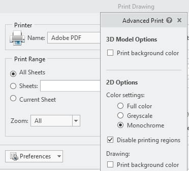

Are you printing through Creo View? If so, you should have options like above where you can control printing in monochrome or color. The creo worker should be where you control how PDFs are generated and if they are color or not. I publish both HPGL/2 default and additional PDF via publishing rules. As far as defaulting based on printer how it prints, I do not think that is a setup you can make in Creo View but you have options on changing printer and color vs monochrome. I would think that the Windows Print Settings setup. IT here would default all our printers to B&W to save money.

We have an own application for printing. It just extracts the pdf and send it to the printer using an Acrobat Reader print command. We have an offer to print monochrome or color for the same price ! Only the TAC of the print counts (Total Area Coverage or toner use in other words).
Publishing of pdf to monochrome or color will be controlled by the worker recipe settings. And once you set either monochrome or color, it will not be altered for the specific drawings.
