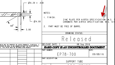

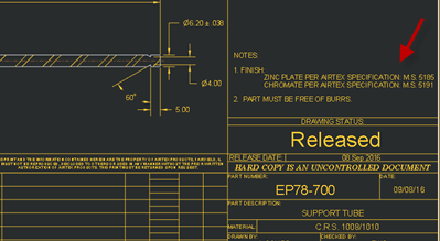

Hi All,
The font style is changed on PDF's after Publishing. It is shifting some of the text out of position and off the page.
CAD Document Screenshot
PDF Screenshot
I had updated the Recipe Editor settings "Font Control" to "Stroked, searchable text" or "Stroked, no searchable text" but it's not working.
It isn't shifting the text. It is using a font where the room left for a "SPACE" is larger than the original font.

Have you checked the fonts installed on the server yet? The publisher can't use or embed or stroke a font it cannot find.

I expect so - the font definitions are not embedded in the Creo drawings. The missing fonts look interesting as seen on the Creo side, but not all the fonts are changed in the Publishing side. There are not a lot of options for breaking some fonts, but having access to only some of them makes it look like they are broken.
Make sure all the fonts you have in the drawing are available to the Publisher.

Designers are using the Custom fonts which are not available on CAD Worker machine. It's working now when I copied the font to Creo default fonts directory.
