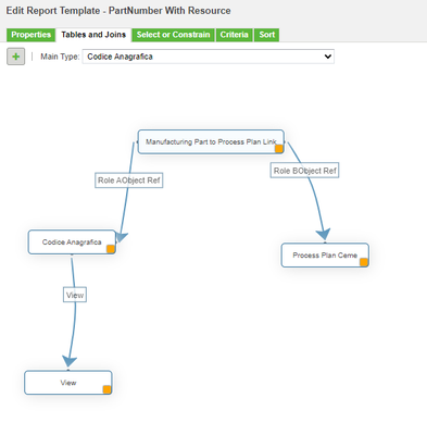

I try to have a Report with latest version of WTpart related to a list of Resouce ( Workcenter,Tooling..).
There is someone able to help me please?

I have a report that links materials, equipment, cycles, operations, and work centers.
The name of the table labels are in Italian but it should not be difficult to retrieve the internal name from query builder.
The definitions table is used, trough criteria, to perform a join (my consultant's suggestion)

My scenario has 4 different Manufacturing Plants.
I need to build a report with connection between Resources and WTPart
Gianpaolo
Sorry Marco but I missed which kind of join I have to use.
Maybe It's not possible to have the direct link between WTPart and a resource.
My first idea was to use one link from WTPart to Process plan "where used" and Resources to Process plan "Where used"
Best regards
Gianpaolo
Hi Marco,
now I have the connection between WTPart of a "choosen" view and the process plan.
I need to use the link "where used" to connect Process plan to resource
Any Ideas?
Marco
Great Marco,
It works as well !!
