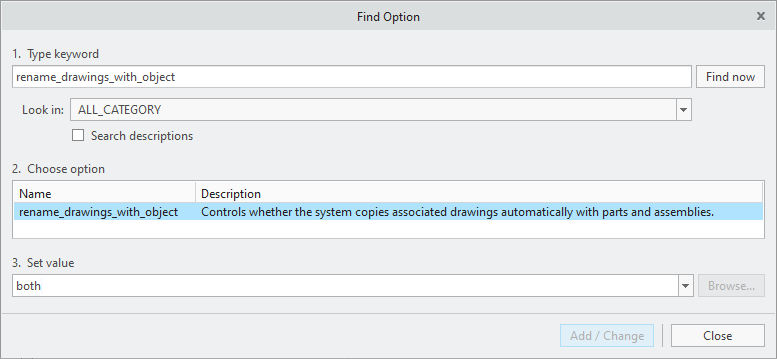

Take a look at the config option 'rename_drawing_with_object':
GiFra_Label
(To:TomU)
I've setted this option on "both" for Creo Stand Alone and linked with Windchill.
But it happens only with WC. So I don't think that this is
TomU
(To:GiFra_Label)
It works in standalone too, but the drawing must be present in the working directory and it must have the same name as the model.

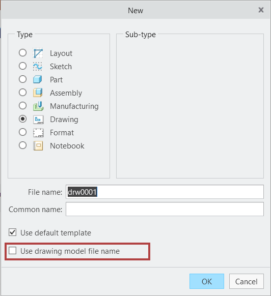

jlecoz
(To:GiFra_Label)
For information, in Creo 8 you now have the option to set the drawing name according to the CAD model automatically when creating a new drawing.
So the workflow would be to create the model first, and then create a new drawing when required using the checking the Use drawing model file name option highlighted below. The drawing will automatically have the same name as the model.
