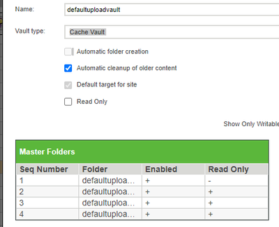

As you can tell, doing some vault maintenance. This is my current setup. I want to shift this to a new storage volume and enable automatic folder creation which I believe is done by creating a new vault.
Is it possible to "change" the defaultuploadvault to a new one? Since there are no vaulting rules which tied to this vault, how is revaulting accomplished?

Closing this one out with some thing I learned, its important to keep up on system maintenance. I followed steps to reset replication which cleared up some items and followed https://www.ptc.com/en/support/article/CS112459?source=search to initiate a forceSync. Default cache vault dropped to 0 not. I am less concerned about recreating to do automatic folder creation since this vault should be kept to zero. Its just after years of skipped attention, a divestiture and removal of a remote replicate server, I think things got backed up. All clear now and adding to my notes.
