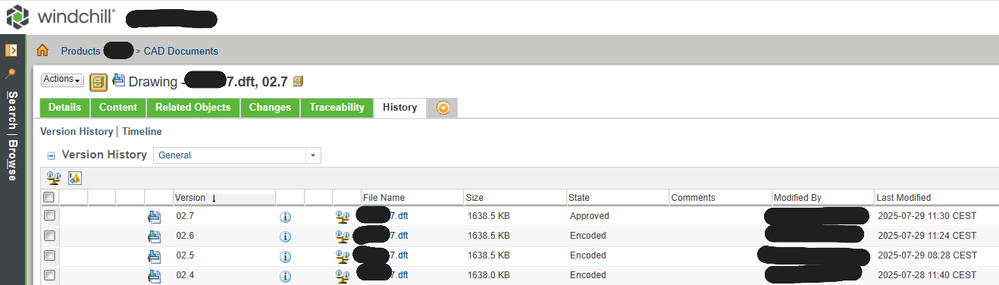

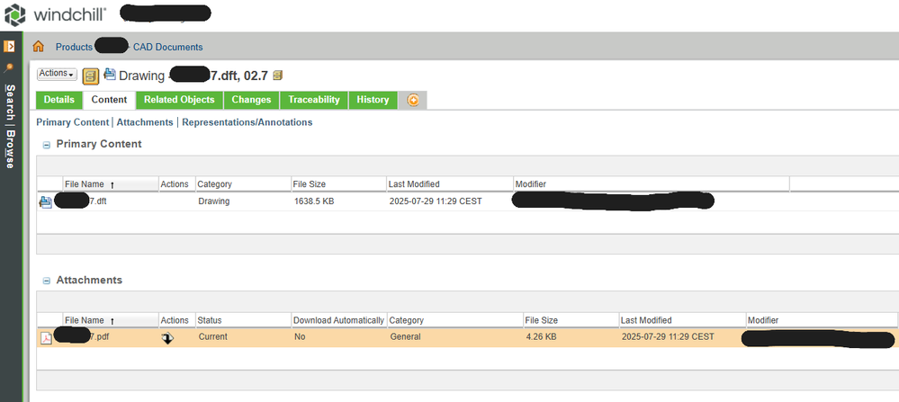

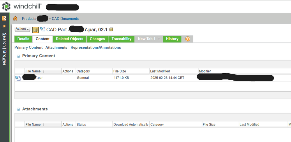

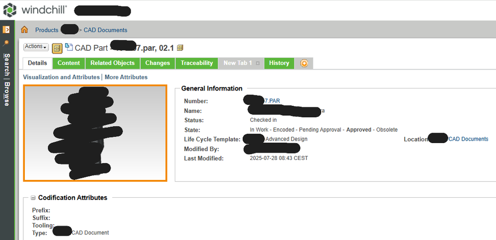

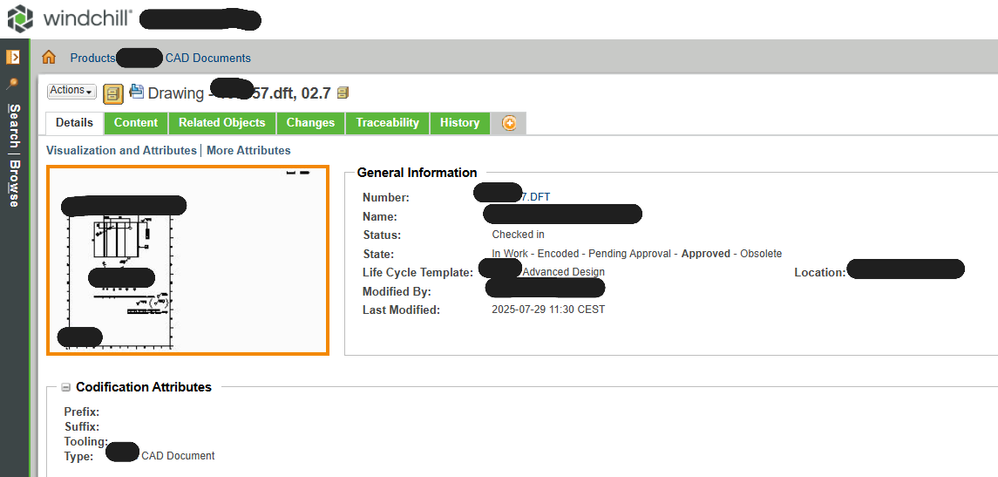

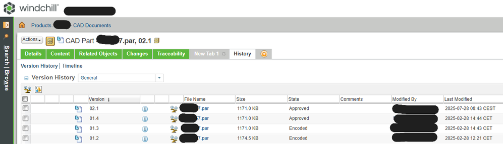

One of our engineers just had the problem.
He has revised and modified a CAD model, but after the check in the CAD file was the "previous one", like the commonspace one (or the server side WS CAD file).
SolidEdge file latest iterationSolidEdge file latest iterationContent of the iterationContent of the iterationHistory of the CAD fileHistory of the CAD file
We have a further problem with the drawing; in the local WS the number of the revisions on the drawing frame is 2 and it is right, but in the Windchill PDF it is still 1 while other changes have been properly applied.
SolidEdge drawing file latest iterationSolidEdge drawing file latest iterationCAD file contentCAD file contentDrawing historyDrawing history
